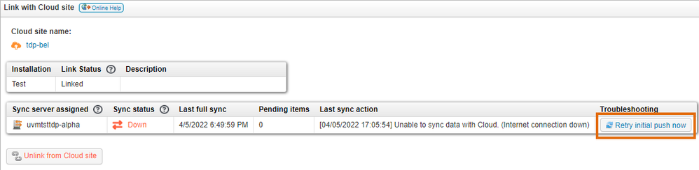

- If your initial push failed for a reason that could be resolved with a retry, the Lansweeper web console may offer you the Retry initial push now button. If available, this button is displayed in the Troubleshooting column of the Configuration > Link With Cloud Site menu.
 If your internet connection was lost after submitting your Cloud link settings for instance, you can use the button to retry the sync.

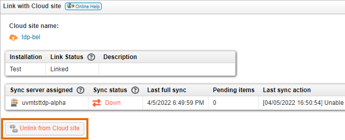

- If no retry button is offered in the Cloud menu or if the sync still fails after a retry, you can try removing the link to Cloud and adding it again.
 Select Unlink from Cloud site and wait for the unlink to complete. Afterward, you can select Link with Cloud site to try the link again.
