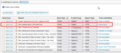

Not entirely sure if this would be the answer your looking for, but I use this report to send me emails whenever a new device shows up on my network.
New assets seen in the past hour

Then in my E-mail/Export reports section I added this highlighted section to get the reports straight in my inbox.

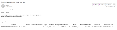

Result looks like this:
Hope this helps.
Hope this helps.
