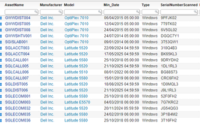

2. There are no duplicates on the your screenshot - every asset has 2 sequental warranties.
6 REPLIES 6
JZastow
both fix's sort of work but now i am missing the Display name from AD and instead of getting 1 asset per page i still get duplicates but 2 is easer to work with then 100's of the same asset
FYI i talked to a SQL program about the duplicates entrees  had me and Min to 2 lines

That sucks they have no way to remove duplicates entrees, it funny that only some of the assets do that and not others
