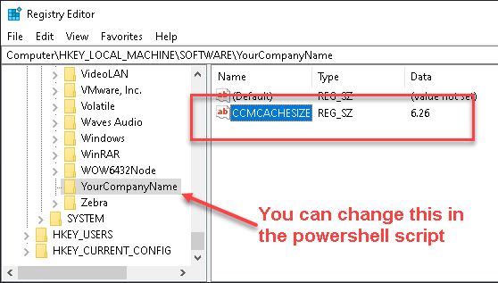

After running the script you should now see the new registry key and value like this.

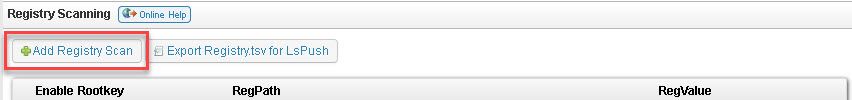

In Lansweeper go to "Scanning" --> "File & Registry Scanning"
Under "Registry Scanning" Click "Add Registry Scan.

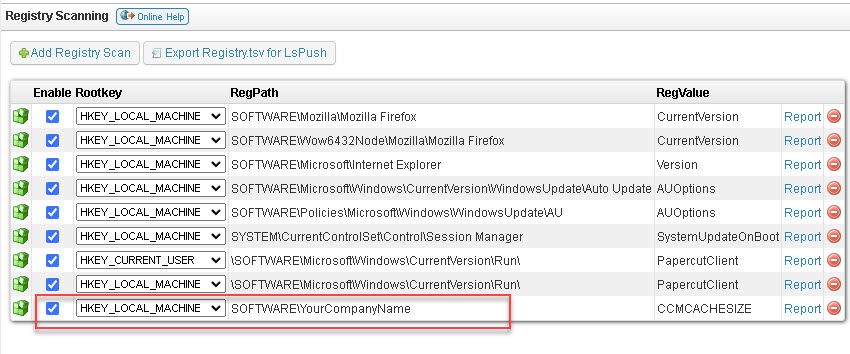

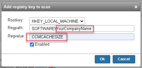

  • Add your companies name to the end of the RegPatch
  • Give the RegValue a name.
  • Click OK (It should look something like this..)
Now you should see that key in the Registry Scanning

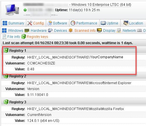

Now you can see that value on each device or in a report.

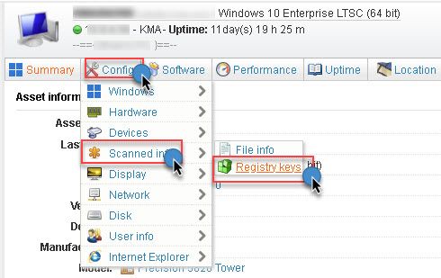

To see information for each device
To see the value on each device, go to that device's page --> Click Config --> Scanned Items --> Registry Keys.
You will see the newly scanned registry key.
