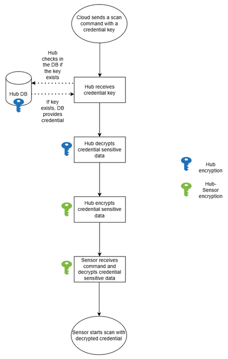

How are the credentials handled in rest and in transit when using Network Discovery?
Credential storage
Credentials are securely stored in the Discovery Hub database using two layers of encryption:
  1. The database itself is fully encrypted, and can only be used by the current installation.
  2. Credentials are encrypted separately using advanced security measures. The encryption key is stored independently, and is only accessible by the machine itself, ensuring enhanced protection.
Credential usage
When a credential is used for scanning a target on a sensor, the encryption process differs from how credentials are stored in the Discovery Hub:
  • When a sensor is started, it will generate a Public/Private key pair, which is only kept in memory.
  • After a successfully authenticating with the Hub, the sensor shares its Public key with the Hub.
  • When a sensor needs a credential for scanning a target:
    1. The Hub retrieves the encrypted credential and decrypts it.
    2. The credential is immediately re-encrypted using the sensor's Public key.
This process ensures that only the designated sensor has the capability to decrypt and utilize the credential as needed.
Credentials received from Lansweeper Sites
A similar encryption process is applied when credentials are received from Lansweeper Sites:
  • The Hub generates a Public/Private key pair, and shares the Public key with Lansweeper Sites.
  • When a user enters a new credential in Lansweeper Sites, it is encrypted before being sent to the Hub.
  • Upon receiving the encrypted credential, the Hub decrypts and securely stores it locally.
Flow diagram
