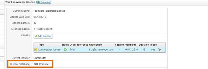

Each ticket in the Lansweeper helpdesk has a numeric ID, listed next to the ticket title. If you're testing the helpdesk, you may at one point want to delete all of your test tickets and start over. If you do, you may notice that IDs previously assigned to other tickets are not reused. You can manually reset the ticket ID counter to a specific number, so new tickets start counting from that point onward. The exact procedure you should follow depends on whether your database is hosted in the Microsoft SQL LocalDB, Microsoft SQL Server or deprecated Microsoft SQL Compact database server. You can verify which database server you are using with the ConfigEditor tool or in the Lansweeper web console. procedure-checking-database-server.jpg

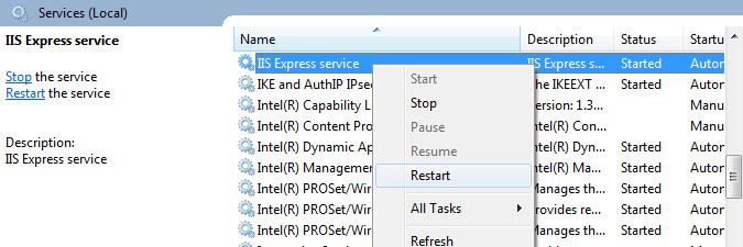

  6. Restart your web server service in Windows Services. Keep in mind that this will log everyone out of the console. Your web server service is either IIS Express or World Wide Web Publishing Service (IIS).procedure-restarting-the-web-server-service.jpg
