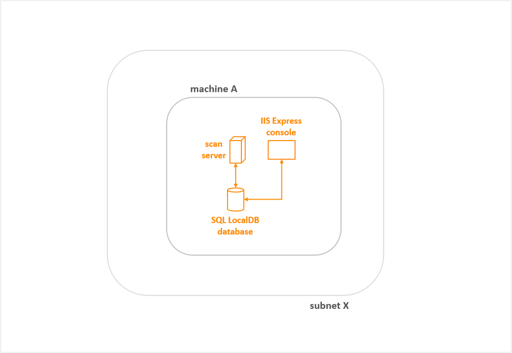

Basic network with a single subnet

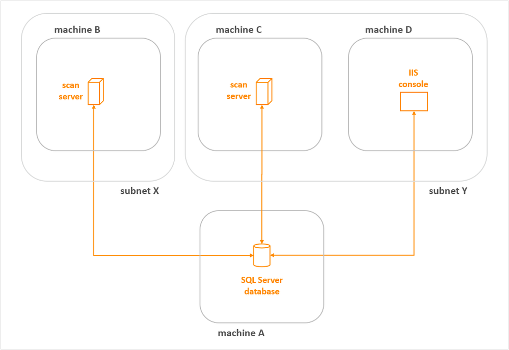

Larger network with multiple subnets

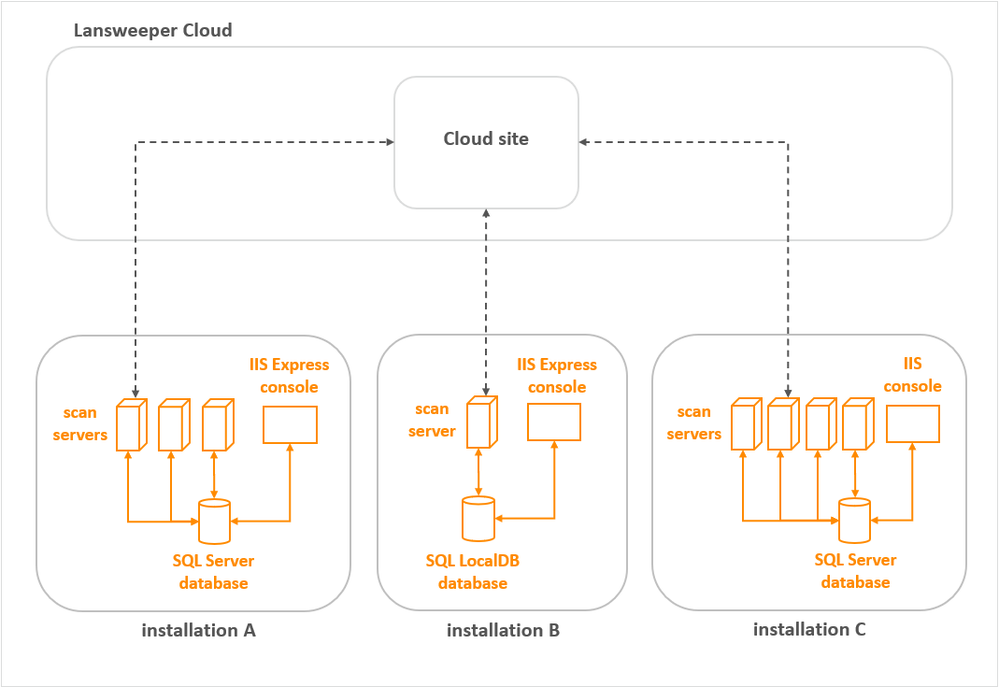

Multiple isolated networks with one or more subnets
