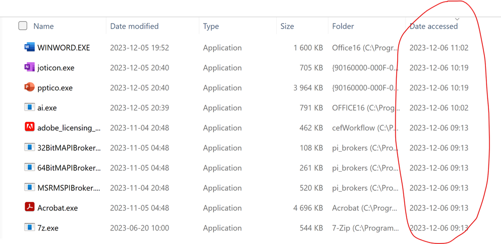

I do have a question though. You mentioned that using file inventory (last accessed) not was a viable option since the command itself would trigger an access, and hence tamper with the result. However, I remember when using SCCM a long time ago, that they were able via hardware inventory (without software metering enabled) to get the LastUsedTime for any exe-file, an information piece that they are exposing in the view v_GS_CCM_RECENTLY_USED_APPS
My guess is that the field they are looking at is the "Date accessed" file property that can be enabled/disabled by setting the reg key NtfsDisableLastAccessUpdate.
Is there any way to include this information for all exe-files when performing an agentless Lansweeper inventory?date accessed.png

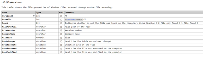

That is an interesting find! Unfortunately, the properties Lansweeper scans are fixed. Here is what the documentation has listed as fields we retrieve:
When reported on, you can see that LastAccessed has todays date which is equal to the asset's last scan date and time.
