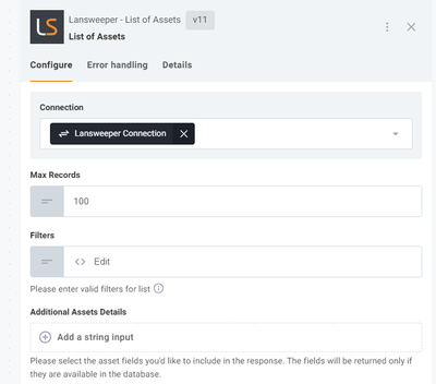

Limit the number of Max Records: some actions have a "Max Records" input to limit the maximum number of results. During the workflow creation, you can, for example, limit the number of assets to 100; you will see the results in the Output tab, and the test execution will be faster. Remember to remove the Max Records input when you finish creating the workflow.

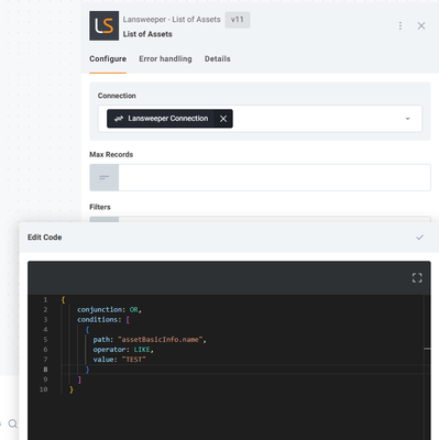

- Add a Filter: the Max Records input returns the first items found, but you might want to use a different data set during your testing. You can also add your filtering criteria to the Filter input, like filtering an asset type or asset names containing a string. Here is more information about how to use the List of Assets filtering input: https://community.lansweeper.com/t5/connectors/lansweeper-connector/ta-p/85179#toc-hId--13128466.
