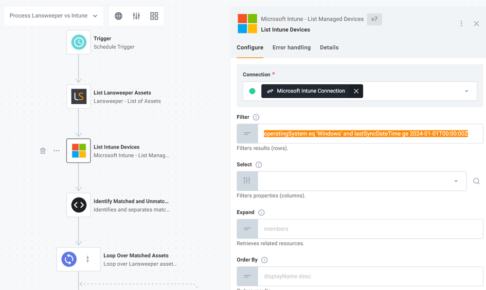

Hey All - I need to review this Pro-Tip flow (was my first go at a flow) - there's a few things that need fixing especially for larger environments -  one thing to do now is add  'operatingSystem eq 'Windows' and lastSyncDateTime ge 2024-01-01T00:00:00Z'   to the intune list devices filter.2025-07-15 00_08_33-Lansweeper.png
