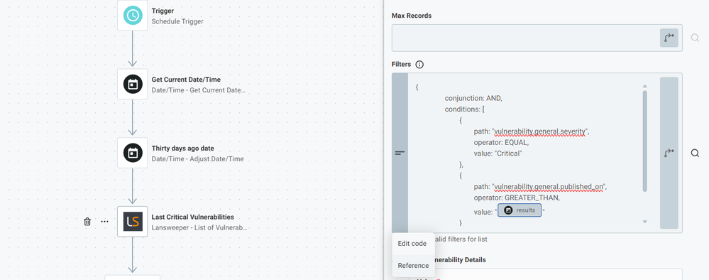

Your filter looks good. The only remaining step is to make the date dynamic, as you mentioned. In the recently added template “Create ServiceDesk request for critical vulnerabilities,” you’ll find an example in the first three steps. Basically, you’ll need to:
  • Get the current date (Get Current Date/Time).
  • Subtract X days from that date (Adjust Date/Time).
  • Reference that date in your List of Assets filter. In that step, select “Reference” using the grey button to the left of the Filter field.

Works as advertised . Thanks for the feedback !
