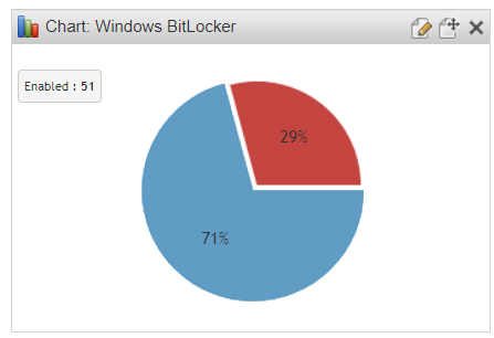

Hello I created this simple chart report to count how many computers have with BitLocker.
The problem is  some of the computers are no possible to activate and I want to exclude from the chart report, I have another report with all computers but in the chart I just what to show the available devices that had Hardware with tpm.  For Manager view.
SO I would like to exclude some computers by name in the count.
This is the report:
Select Top 1000000 Case
    When tblEncryptableVolume.ProtectionStatus = 0 Then 'Disabled'
    When tblEncryptableVolume.ProtectionStatus = 1 Then 'Enabled'
    Else 'UNKNOWN'
  End As [Bitlocker Status],
  Count(tblEncryptableVolume.ProtectionStatus) As Total
From tblAssets
  Inner Join tblEncryptableVolume On
      tblAssets.AssetID = tblEncryptableVolume.AssetId
Where (tblEncryptableVolume.ProtectionStatus = 0 Or
    tblEncryptableVolume.ProtectionStatus = 1)
Group By Case
    Else 'UNKNOWN'
  End,
Order By Total Desc
this is an image of the Chart:

hi! thanks for the reply the, report is working fine!! but I just what to add a line to exclude specific computer names, something like where....computer name is not   XXXX or XXXX or xxxx, this way those computers won't take into account, but I don't know where to write this "where" clause.
rader
Champion Sweeper III
Try adding in the tblAssets.AssetName to the report and then filter based on that field.
Here's an example.

Here I've filtered out any asset that starts with V {'v%'}, has the number 0 in it {'%0%'}  AND assets that start with P {'p%'}. Using the Not Like filters out the undesired assets.
Just adjust to your needs.
