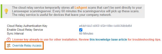

Ensure continuous data transfer via the relay for LsAgent clients after migration
  • Make sure to keep your original Lansweeper license key applied to your installation after the migration. In most cases, if you migrate your installation and Lansweeper database correctly, your license key will be automatically migrated as well.
  • Ensure that your migrated installation effectively takes over LsAgent scan retrieval.
    1. Go to the Scanning > Relay Configuration menu of the migrated installation
    2. Select Override Relay Access.
By following these steps, you can guarantee that your LsAgent clients continue sending data over the relay seamlessly after migrating your Lansweeper installation.
