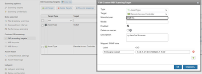

You have to add OIDs to collect fimware version
1.3.6.1.4.1.674.10892.5.1.1.8.0
