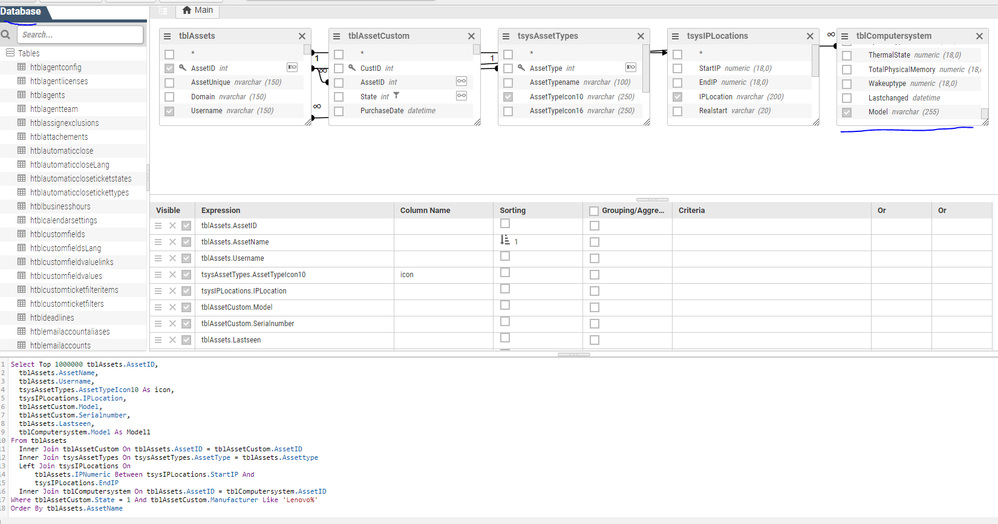

I know that when I launch "msinfo32.exe" and go in Material ressources, I have a section Model with the right model, for example : 3692B1G
Otherwise I can run a cmd command (wmic csproduct get name) and I will answer me : 3692B1G
How can I do to have a column with the type of model ?

We found a solution using the report system. You need to add the tblComputersystem database and select the model. Hopefully, the image of our report helps others.
