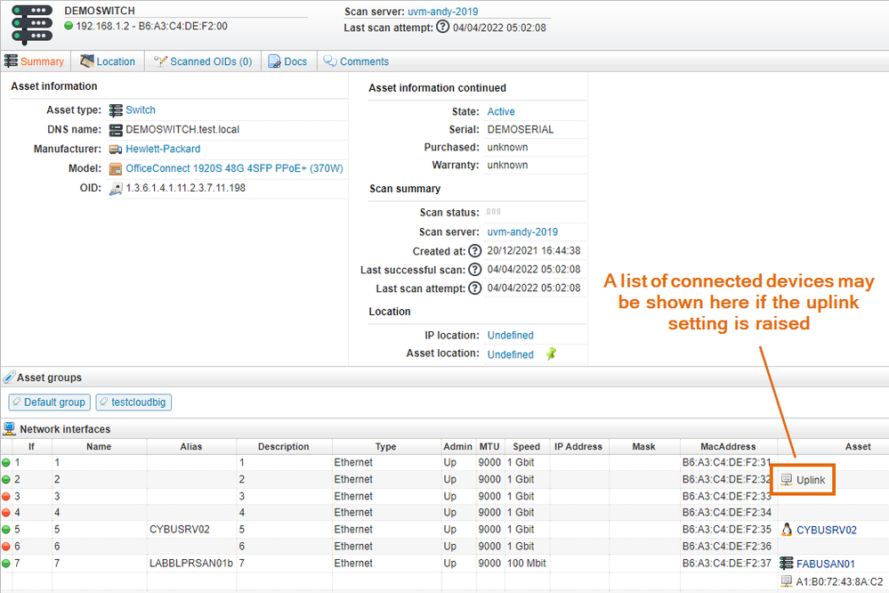

By default, if Lansweeper discovers more than 4 devices connected to a switch port, the port will be deemed to be an uplink. An uplink is a port on a router or switch that is designed to connect to another router, switch or internet access device.
In most cases, the label "uplink" will be correct for switch ports with more than 4 connected devices. However, there may be situations where you want to raise this setting. If you have a server connected to a port for instance, and that server is hosting lots of virtual machines, you may need to raise the uplink setting in order to see all connected devices on the port.

  1. Go to the Configuration > Server Options menu of the web console.
  2. In the Switch scanning section, change the amount of connected devices. The default value is 4 connected devices.
    We recommend only raising the uplink setting as much as is required; submitting large values may impact performance.

Once your switches have been rescanned, any additional connected devices that were detected on a port will be listed on the switch page, if the device count for the port does not exceed your uplink setting. If the device count for the port still exceeds what you've configured as your uplink setting, the port will still be considered an uplink.
