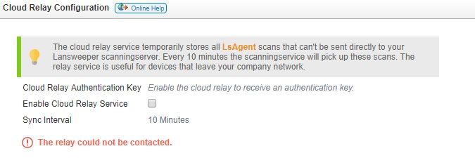

Lansweeper provides the LsAgent to scan your data. While configuring the LsAgent to contact the relay, the following errors may occur:
  • The relay could not be contacted.
  • An unexpected error occurred while contacting the relay.
