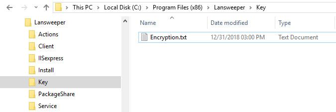

Credentials can no longer be encrypted or decrypted without an encryption key file on your Lansweeper server. A unique Encryption.txt key file is automatically generated and added to the Program Files (x86)\Lansweeper\Key folder on your Lansweeper server when you install Lansweeper 6.0 or a more recent Lansweeper release.

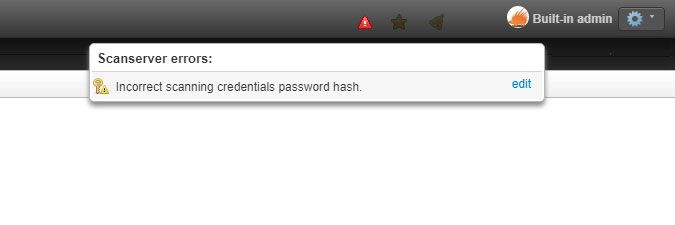

If you spread out your Lansweeper installation over several machines, you need to manually copy one key file to all of your servers, so all servers use the same key. If all servers do not use the same key file or if your key file is changed after submitting credentials, you may see errors similar to the ones below in the Lansweeper web console. These errors indicate that the key file that was used to encrypt your credentials is not (or no longer) the same key file present on your Lansweeper server(s).
Cannot decrypt credential.
Credential and website hashes don't match.
Incorrect scanning credentials password hash.
Mismatch between website and server's password hash.
No valid credentials found. Check encryption file.

  2. If your Lansweeper installation is spread out over several machines, grab the file below from one of those machines. In most cases, the Encryption.txt found on the server hosting the web console is the correct one, i.e. the one used to originally encrypt your credentials.
    Program Files (x86)\Lansweeper\Key\Encryption.txt
    If you cannot find an Encryption.txt file on any of your Lansweeper servers, restart the Lansweeper Server service (scanning service) on one of the servers to generate one.
  3. Copy the Encryption.txt file to the folder found at Program Files (x86)\Lansweeper\Key on any server hosting a Lansweeper component, overwriting any other Encryption.txt files that may already be present on the servers. The Encryption file on all servers hosting a Lansweeper component must be the same.
