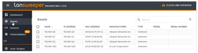

Greetings, we are starting to scan OT devices and are having a hard time to make it work.  Follows the symptoms:
  • Not all OT devices are discovered by Lansweeper.  The only devices that are discovered are as follows:
  • We can ping all OT devices in the network from the Lansweeper OT console.
Has anybody experienced this kind of issues?

The devices that are listed in your screenshot are indeed all switches. The current OT Scanner doesn't 'deepscan' those devices as it was build specifically for OT devices. In future iterations we are aiming to also deepscan IT devices from the same Discovery Hub but for now you would indeed still need the IT Scanner if you want all information (like switch port mapping, serial, firmware etc) for your switches/routers/...
