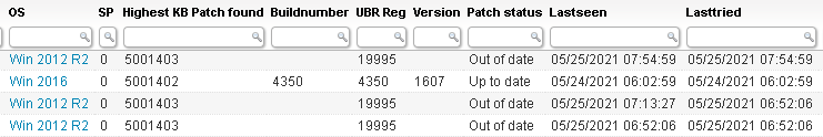

I noticed the UBR number scanned by default with Lansweeper is only working on Windows 2016 and above.
To show this, the UBR Reg value column was added:
