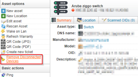

I have discovered a problem with switch and asset relationships. If an asset is discovered on a switchport and then the asset is moved to a different switchport or even to a different switch, the asset will still show on the switchport that the asset was originally discovered on.

Hello there!
You can clear old switch connections by clicking the Remove Disconnected Devices button in the left-hand pane of switch asset pages (see screenshot below). This button will clear all switch port connections that are older than the last successful scan time of the switch in question.
