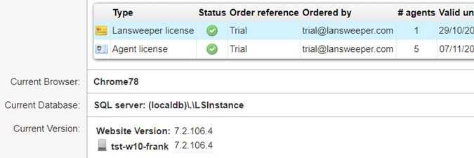

Lansweeper data, reports and settings are stored in a database, which is hosted in either Microsoft SQL Compact, Microsoft SQL LocalDB or Microsoft SQL Server. If your database is hosted in LocalDB, you can move it to SQL Server on the same or a different machine, if at some point required. If you are unsure which database server you are using, browse to the Configuration > Your Lansweeper License section of the web console.

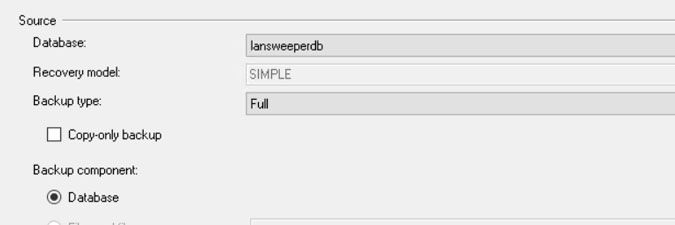

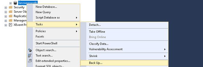

  2. Back up your LocalDB database. Log into SQL Server Management Studio. If SQL Server Management Studio isn't installed on your Lansweeper server, we recommend downloading it online. The instance name you need to submit in Management Studio to access your LocalDB database is "(localdb)\.\LSInstance" and you can access the instance with the Windows user that performed your Lansweeper installation. Create a backup of your LocalDB database by right-clicking the lansweeperdb database in SQL Server Management Studio and selecting Tasks > Back Up ... in the menu. Moving-your-database-from-SQL-LocalDB-to-SQL-Server-2.jpg
    • Database: lansweeperdb
    • Backup type: Full
    • Backup component: Database

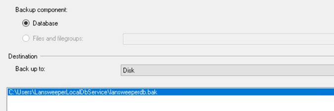

    • Back up to: Disk, add a location where the backup file will be stored.
    • In the Options tab, you can tick Verify Backup When Finished to check the integrity of the backup file.
      Moving-your-database-from-SQL-LocalDB-to-SQL-Server-3.jpgMoving-your-database-from-SQL-LocalDB-to-SQL-Server-4.jpg

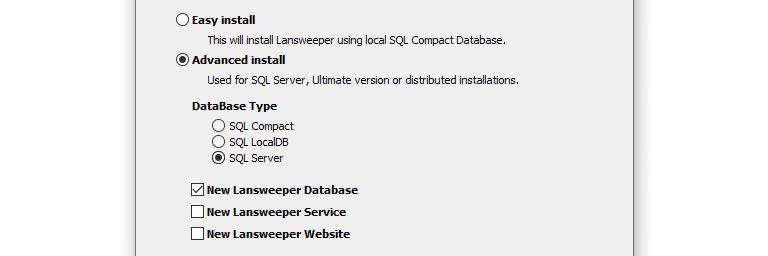

  3. Download the latest Lansweeper installer and run it on your new database server.
  4. Configure the installation exactly as shown below. This will install a default Lansweeper database in the SQL Server instance specified by you. Moving-your-database-from-SQL-LocalDB-to-SQL-Server-10.jpg
    Don't try to manually create the database. Let the installer do this for you.

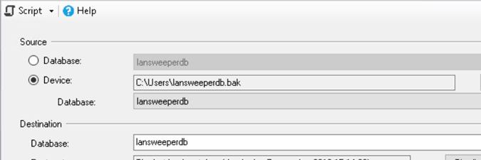

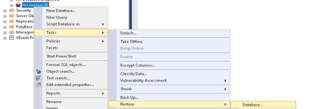

  5. Restore your database backup on your new server by right-clicking the "lansweeperdb" database in SQL Server Management Studio and selecting Tasks > Restore > Database... in the menu.
  6. Select Device under Source and browse to the backup file "lansweeperdb.bak" that you previously created. Make sure you've selected the correct destination "lansweeperdb" and source for the restore operation.
  7. In the Files tab select Relocate all files to folder and check Overwrite the existing database in the Options tab. Select OK to perform the restore.  Moving-your-database-from-SQL-LocalDB-to-SQL-Server-9.jpg Moving-your-database-from-SQL-LocalDB-to-SQL-Server-8.jpg
