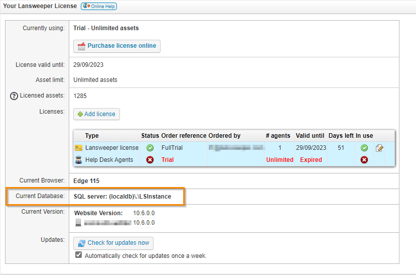

If you are unsure which database server you are using, browse to the Configuration > Your Lansweeper License section of the web console.

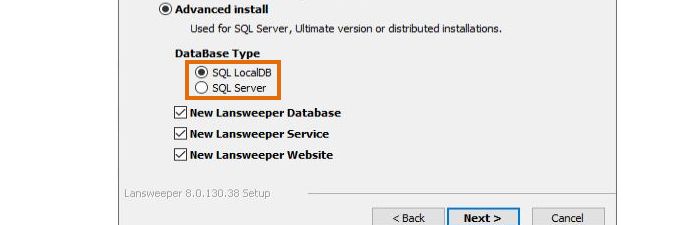

  4. Perform an Advanced install of Lansweeper on the computer you want to migrate to and select SQL Server or SQL LocalDB as your database server. Installation instructions can be found in this knowledge base article.procedure_performing_an-advanced-install-all-components.jpg

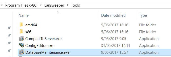

  7. If the scanning configuration of the old scanning server should be migrated to the new scanning server, run the DatabaseMaintenance tool on the new server, found at Program Files (x86)\Lansweeper\Tools\DatabaseMaintenance.exe.
    Otherwise, skip to step 9.
  8. If the scanning configuration of the old scanning server should be migrated to the new scanning server, execute the script below in the Script Execution tab of the tool. You'll need to replace "OldServer" with the NetBIOS name of the old scanning server and "NewServer" with the NetBIOS name of the new scanning server, leaving the single quotes in place. The script deletes the new, empty tab that will have been generated for the new scanning server under Scanning > Scanning Targets in the web console and transfers the old scanning server settings to the new server.
