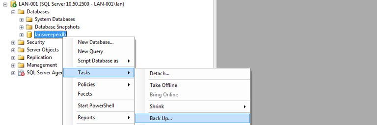

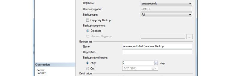

  3. Back up your database by right-clicking lansweeperdb in SQL Server Management Studio and selecting Tasks > Back Up... in the menu. If SQL Server Management Studio isn't installed on your Lansweeper server, we recommend downloading it online.Moving-your-database-to-a-different-server-2.jpgMoving-your-database-to-a-different-server-3.jpg
    • Database: lansweeperdb
    • Backup type: Full
    • Backup component: Database
    • Name: make sure this is something other than lansweeperdb, to avoid overwriting your existing database.
    • In the Options tab, you can tick Verify Backup When Finished to check the integrity of the backup file.

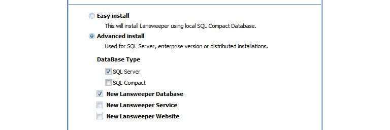

  4. Download the latest Lansweeper installer and run it on your new database server.
  5. Configure the wizard exactly as shown below. This will install a default Lansweeper database in the SQL Server instance specified by you.Moving-your-database-to-a-different-server-4.jpg
    Don't try to manually create the database. Let the installer do this for you.

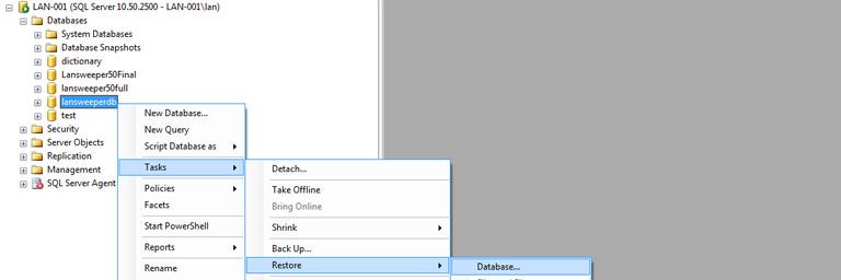

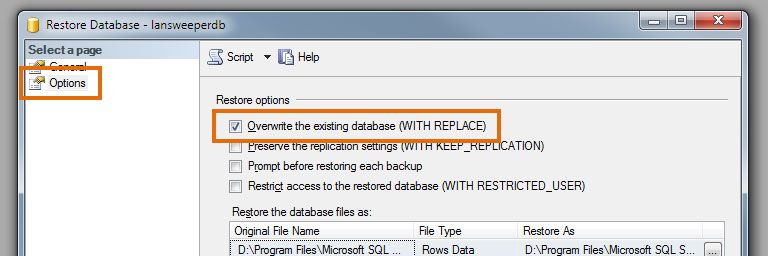

  6. Restore your database backup on your new server by right-clicking the lansweeperdb database in SQL Server Management Studio and selecting Tasks > Restore> Database... in the menu. Make sure you've selected the correct destination (lansweeperdb) and source for the restore operation and that "Overwrite the existing database" is checked in the Options tab. Select Ok to restore the database.Moving-your-database-to-a-different-server-5.jpgMoving-your-database-to-a-different-server-6.jpg
    Make sure the overwrite box is checked. Otherwise, the following error may be generated:
    The backup set holds a backup of a database other than the existing 'lansweeperdb' database.
