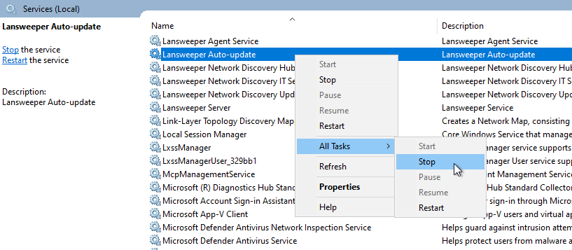

  2. Stop the Lansweeper Auto-update service in Windows Services.Restore your installation 1.png

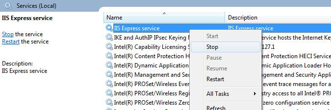

  3. Stop your web server service in Windows Services. Keep in mind that this will log everyone out of the console. Your web server service is either IIS Express or World Wide Web Publishing Service (IIS).procedure-stopping-the-web-server-service.jpg

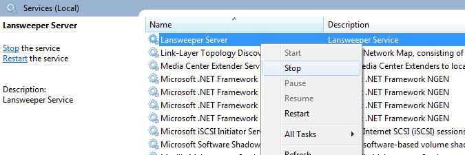

  1. Stop the Lansweeper Server service in Windows Services.procedure-stopping-the-lansweeper-service.jpg

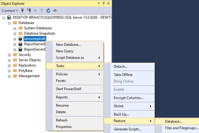

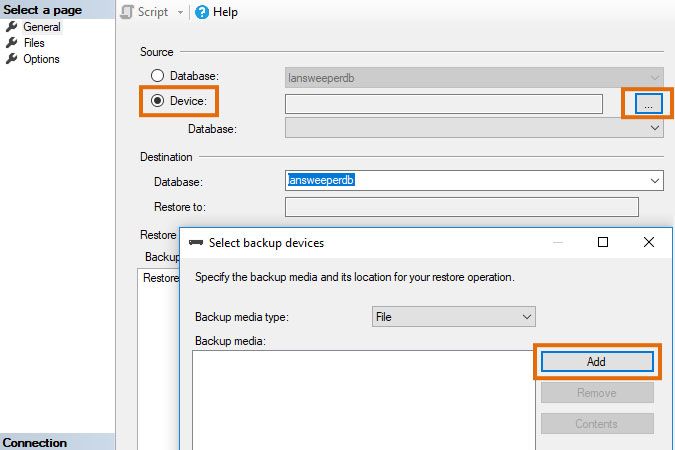

  4. Right-click the lansweeperdb database in SQL Server Management Studio and select Tasks > Restore > Database... to open the restore wizard. If SQL Server Management Studio isn't installed on your Lansweeper server, we recommend downloading it online.restoring-your-installation-from-a-backup-1.jpg
  5. In the General tab of the restore wizard, select the correct destination (lansweeperdb) and source for the restore operation. If your backup is a .bak file, select the Device option under Source and select the button with the three dots to open a pop-up where you can select your file.restoring-your-installation-from-a-backup-2.jpg
    If you're restoring a SQL LocalDB database, do not change the file path of your mdf and ldf files in the Files tab. They must be stored in the Lansweeper\SQL Data folder. The Restore As path in the Files tab must be the Lansweeper\SQL Data folder belonging to your Lansweeper database.

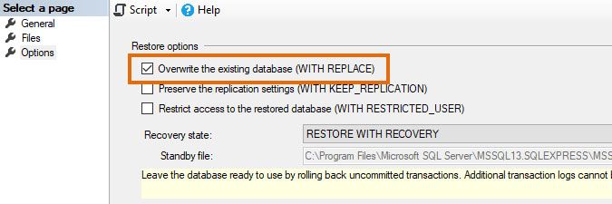

  6. In the Options tab of the restore wizard, tick Overwrite The Existing Database, and select OK to perform the database restore.restoring-your-installation-from-a-backup-3.jpg
    Make sure the overwrite box is checked. Otherwise, the following error may be generated: "The backup set holds a backup of a database other than the existing 'lansweeperdb' database."

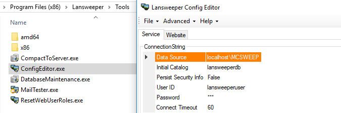

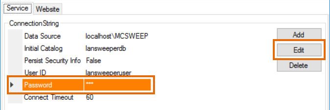

  8. Run the ConfigEditor tool on the server(s) hosting your Lansweeper Server service and web console. The tool can be found at Program Files (x86)\Lansweeper\Tools\ConfigEditor.exe.menu-configeditor.jpg
  9. Click through any warnings the tool may be giving you about your password being incorrect.
  10. Select the Password field and select Edit.procedure-configeditor-service-password-change.jpg
  11. Submit the same password you used in the database script and select Save.
  12. If the ConfigEditor tool has multiple tabs due to your server hosting multiple Lansweeper components, select the other tab, click through any warnings and repeat the password-changing process.procedure-configeditor-website-password-change.jpg
