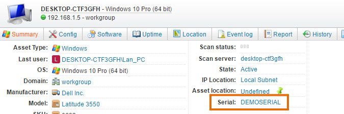

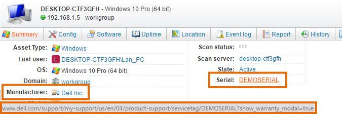

The serial number of Dell and HP assets is clickable in the Summary tab, for assets whose asset serial was scanned. The serial link takes you to the page on Dell or HP's website that lists that specific asset's warranty information, so you don't need to manually look up warranty details.

    You need to research which page on the manufacturer's website can be used to view warranty information and copy that link. Ideally, the manufacturer should allow for direct linking to a specific asset's warranty details by including the asset serial in the URL.
    If the manufacturer allows this, you can use the {assettag} parameter as a placeholder for the asset serial when submitting the URL in Lansweeper. On an individual asset page, the parameter will automatically be replaced with that specific asset's serial. {model} and {systemsku} are available parameters as well, which are placeholders for the asset model and system SKU.
