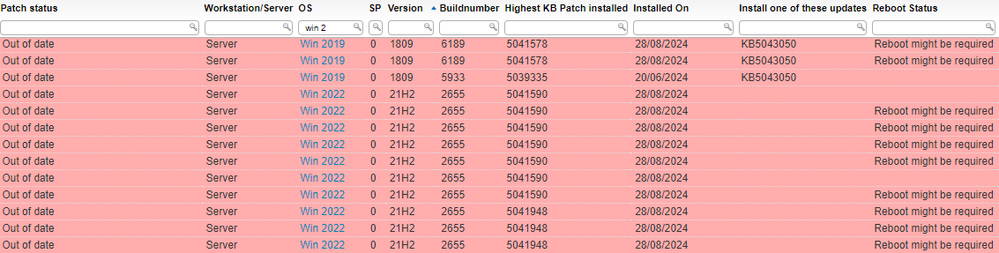

Hi - thanks for reinstating the recommended patches column.  Just a quick question - on the new report our 2022 servers are showing as 'out of date' but there is nothing recommended to install?  Please advise if this is correct.
Many thanks
Mike

You're correct, there was a mistake in the report for Server 2022 specifically. I fixed it. If you refresh the website and grab the latest version it should be fixed.

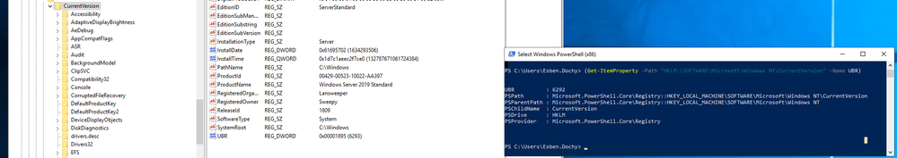

I just ran some test and its indeed an issue that seems to be easily reproducible. From what I can tell this is a Microsoft mistake although I am not really sure how it works.
When I query the source for build information via PowerShell I also get build 6292, however, in the actual registry key, it says 6293. I have no idea how this works, but it seems that this is where Microsoft made a mistake.
Since Lansweeper will use a programmatic way to retrieve the build, it will receive 6292 from the OS.
What I've done is adjust the report to look at 6292 this time, I assume that next month we won't have the same issue. You can grab the new report from the report page or adjust it yourself in your report.
