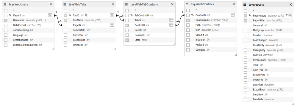

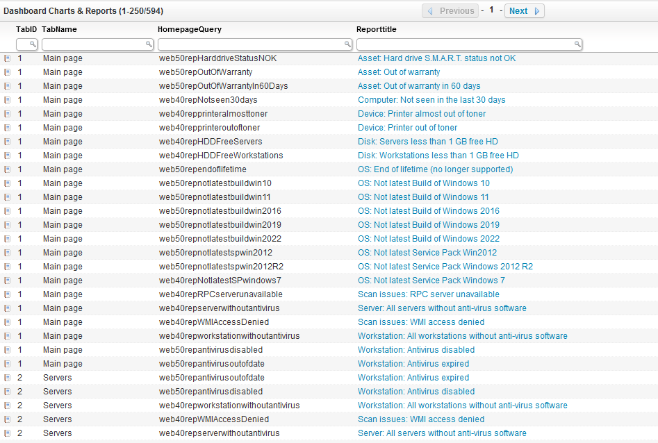

I'm looking to create a report to list all the dashboards and the widgets on them.
I've found some of the information in tsysWebTabs, tsysreportpages and tsysreports, and have a basic linking of the dashboard names to the tabs assigned to them, but I can't find the widget tables to link these together.
Here's what I've got so far:
Select Top 1000000 tsysWebTabs.TabID,
  tsysWebTabs.TabName,
  tsysreportpages.HomepageQuery,
  tsysreports.Reporttitle,
  tsysreports.Reportquery
From tsysWebTabs
  Inner Join tsysreportpages On tsysWebTabs.PageID = tsysreportpages.PageID
  Inner Join tsysreports On
      tsysreports.Reportquery = tsysreportpages.HomepageQuery
Order By tsysWebTabs.TabID
Some of the TabID's line up with the dashboard names, like Main page shown here, and some don't, like #2 Servers, which I don't have on my dashboard. The HomepageQuery and the Reporttitle are wrong too.
Is there a DB table for the Widgets?
Anyone else come across a solution for this?

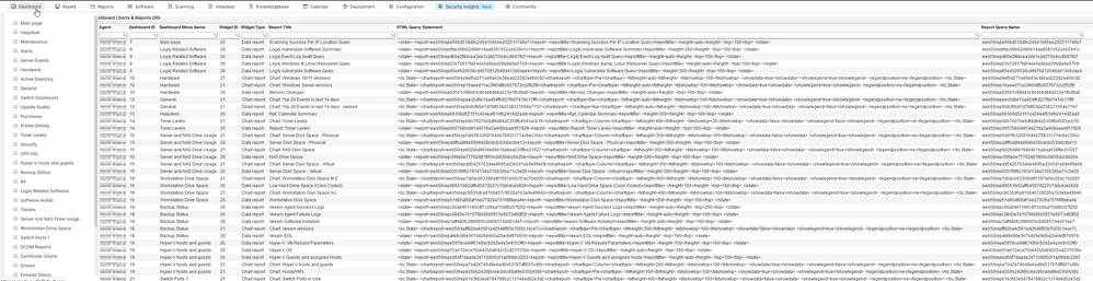

Made it a little further in case anyone is interested. The primary challenge to creating this report is that documentation to the tables I'm digging through is non-existent, at least that I can find.
At this point the report only pulls the custom reports/charts from all the dashboard tabs. Here's the latest sample from my dashboards.
Really large image to show the query statementReally large image to show the query statement
The challenge was to extract the HTML Query Statement's report name (custom reports seem to start with 'web50rep' and are 40 characters long. Using the SubString (CAST... to pull the report name out of tsysWebTabControls.State, then match it to the tsysreports.ReportQuery field in an unrelated database, then display the Reporttitle to get the real-world name of the report and/or chart for display. The SubString(CAST) was necessary to have two different data types (ntype -> nvarchar) match string values.
Now the only thing I'm struggling with is how to get the build reports to display on the same report. Their in the tsysWebControls database under 'web40rep...', category type 1. All the custom reports above are category type 3, and HelpDesk reports are category type 2, fyi.
