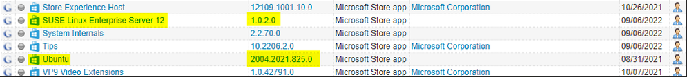

@papillon68000
On client systems, you can find installed WSL distributions in the list of installed MS Store apps. For example, for Ubuntu and Suse:
This feature requires the SOFTWAREMSSTOREAPPS scanning item to be enabled on the Scanning/Scanned Item Interval page.
Not sure this approach will work on servers without MS Store though.
