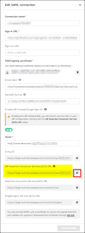

Step 1: Copy the IdP ACS URL from Lansweeper
  1. Log in to Lansweeper as an SSO Manager.
  2. To find the most recent connection parameters for your Lansweeper Site, go to Settings > Single Sign-On.
  3. Copy the IdP ACS (Assertion Consumer Service) URL displayed in the configuration by using the copy button.

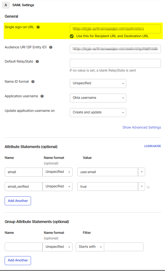

 Step 2: Update the SSO Configuration in Okta
  1. Log in to the Okta Admin Console.
  2. Go to Applications and select your Lansweeper SAML application.
  3. Update the SSO URL with the copied value from your Lansweeper Site.

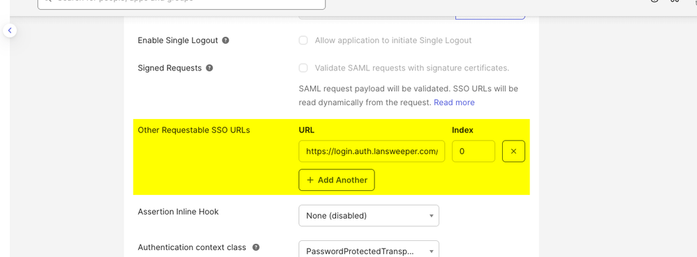

Step 3: Add the ACS URL as an “Other Requestable SSO URL”
  1. Click Show Advanced Settings.
  2. In the Other Requestable SSO URLs section, add a new entry.
  3. Set the URL value to the current Lansweeper ACS URL: https://login.auth.lansweeperdev.com/samlv2/acs/
  4. Save the configuration changes.
