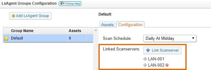

If you're sending LsAgent scans directly to scan servers:
  1. In the Lansweeper web console, go to Scanning >LsAgent scanning.
  2. Select a group of LsAgent assets, then Configuration. Next, either:
If no server can be reached directly and cloud relay access has been set up for LsAgent, LsAgent will try to send data to the relay.

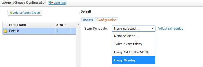

  3. Adjust the Scan schedule so that scans are run less frequently.
