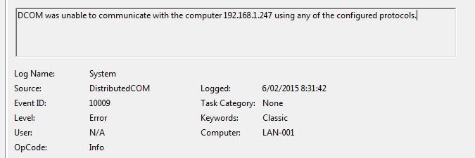

After installing Lansweeper and scanning your network, you may start seeing entries with an Event ID like the one below in your Lansweeper server's Event Viewer. While your Event Viewer classifies these entries as errors, they are just informational messages and can generally be ignored.
When Lansweeper scans a Windows computer, it uses DCOM to establish the initial connection to the client machine. If the client machine is offline or firewalled, DCOM automatically logs an error in your server's Event Viewer. This error indicates that Lansweeper was unable to scan the client machine, but does not point to an underlying issue with your server or Lansweeper installation.

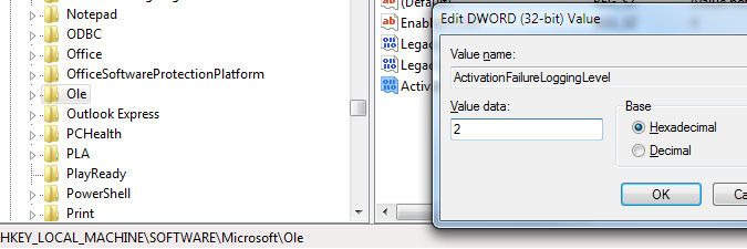

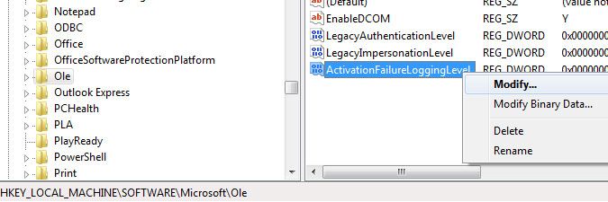

  2. Go to HKEY_LOCAL_MACHINE\SOFTWARE\Microsoft\Ole and Modify the ActivationFailureLoggingLevel.
  3. Set the ActivationFailureLoggingLevel value to "2".

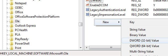

  4. If the ActivationFailureLoggingLevel value does not exist, manually create it.
    Keep in mind that setting this value to "2" will prevent DCOM from logging any failures.
