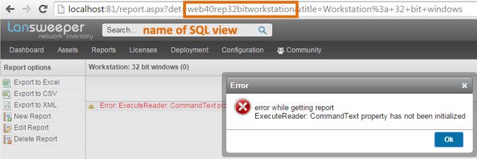

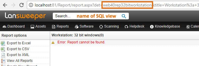

If someone deletes report views from your SQL instance, or if your Lansweeper database is moved without moving the report views as well, you will encounter one of the errors below when opening the affected reports in the Reports tab of the web console. The exact error message depends on the Lansweeper version used. The name of the missing report view can be seen in the web console URL.
Error: ExecuteReader: CommandText property has not been initialized
Error: Report cannot be found
