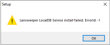

One of the available database server options when installing Lansweeper is SQL LocalDB. When you choose to host the Lansweeper database under LocalDB, the Lansweeper installer creates a service that runs the SQL LocalDB database server. Afterwards, this service will run under a user account created by the installer, "NT Service\LansweeperLocalDbService". In order for the aforementioned user account to successfully run the LocalDB service, it must be granted the necessary permission to log on as a service. Lansweeper automatically tries to give NT Service\LansweeperLocalDbService this permission. If you're using the SQL LocalDb database provider, you may encounter the error below when updating or installing Lansweeper.

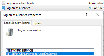

  2. When the Lansweeper LocalDB Service starts, it reconfigures local Windows security policy by adding the "NT Service\LansweeperLocalDbService" account to the Log on as a service policy. This policy can be found in Windows on your Lansweeper server by going to Local Computer Policy > Windows Settings > Security Settings > Local Policies > User Rights Assignment in the Local Computer Policy editor, which is accessible via MMC.

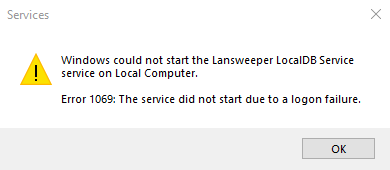

  3. Group policy may disable or override local policy in a domain environment. If the LocalDB service was unable to log on, the error below may be thrown.

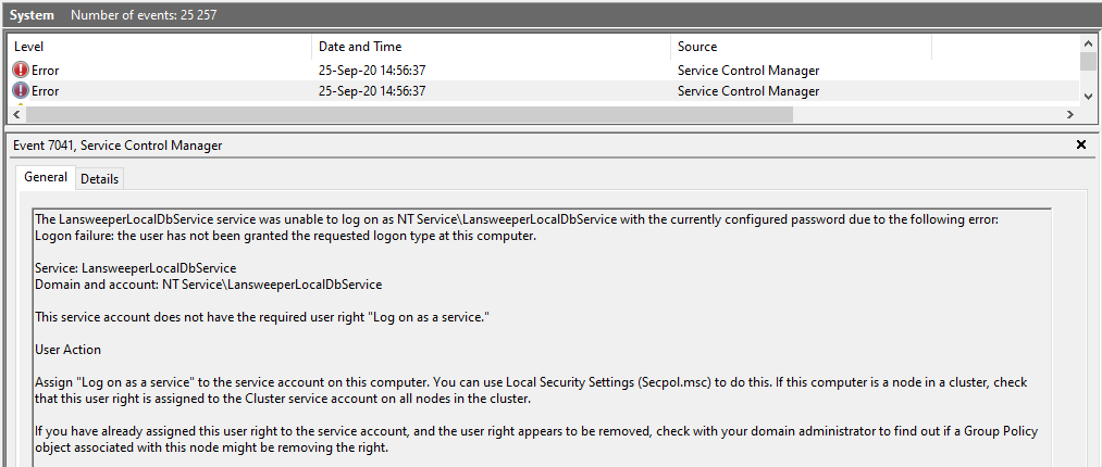

  4. Additionally, an event such as the one below is usually found in the Event Viewer of your Lansweeper server under Windows Logs\Application or Windows Logs\System.
  5. You can resolve this by modifying your domain's group policy in Active Directory by adding "NT Service\LansweeperLocalDbService" to the Log on as a service policy for your Lansweeper server. Regardless of whether you're in a domain or not, the "NT Service\LansweeperLocalDbService" user must be used, other accounts are not supported.
