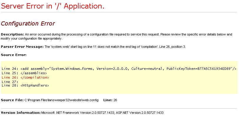

mz3prs
Now I am getting an error with assemblies line...I will going to upload a screenshot.
Hemoco
Lansweeper Alumni
remove the "</compilation>" line
mz3prs
OK that error cleared, but now we got this one....
