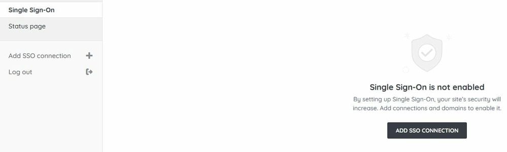

  3. Go to the Single Sign-On menu and select Add SSO Connection.

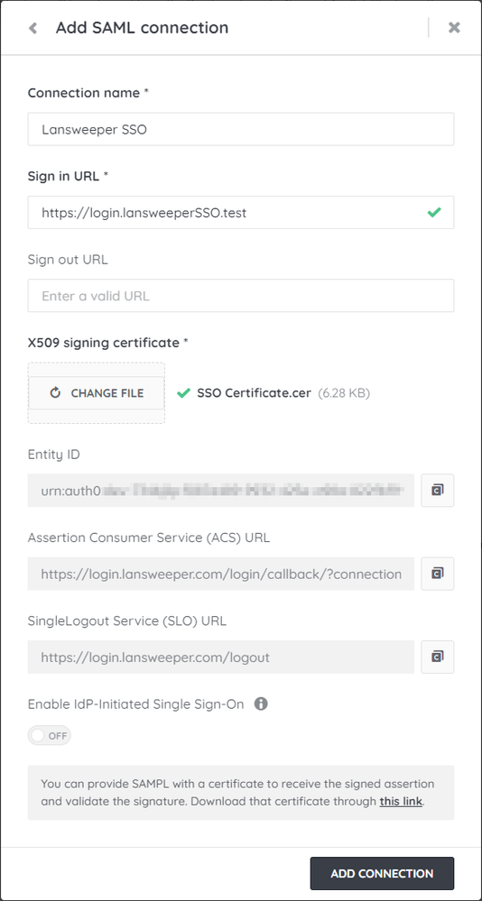

  4. In the resulting pop-up, select the type of SSO connection you want to set up and select Continue
    Lansweeper Sites supports two types of SSO connections, SAML (Security Assertion Markup Language) and OIDC (OpenID Connect). Which one you choose will depend on the identity provider you're using and the type(s) it supports. If you're using Azure AD as your IdP for instance, SAML is a suitable SSO connection type.
  5. Enter a descriptive name for the connection, and several pieces of information regarding the connection. This is information you'll gather from your identity provider (IdP).
    To log in to Lansweeper directly from your IdP with SSO, toggle Enable IdP-Initiated Single Sign-On to On.
    Leaving the toggle Off will result in errors when logging in from your IdP.

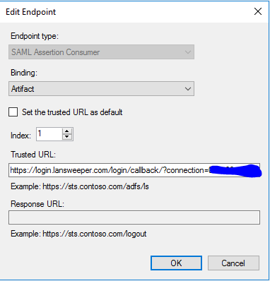

Configure the SSO connection on the IdP side
  1. You'll need to take some of the info provided in the pop-up and input it in your IdP configuration. The location to input the necessary info for the SSO connection will differ depending on the IdP you are using.
    Only Azure AD and Okta are currently supported by the Lansweeper Support team, but there are many more identity providers you can use.

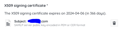

    Consult the website and documentation of your specific identity provider (IdP) for up-to-date instructions on how to configure SAML or OIDC in that IdP. For SAML, make sure the certificate you're providing in the SSO pop-up is a Base64-encoded CER or PEM.
  2. In the attribute setup of your SSO connection on the IdP side, make sure your IdP is configured to send both the user's email and an email_verified attribute to the Site.
    Our knowledge base contains more specific attribute setup instructions for Azure AD and Okta, but the process is similar for other identity providers.
    Do not skip this step. Adding these attributes is important as it's required by Lansweeper Site's underlying SSO login process that a user has an email address, and for that email address to be verified.

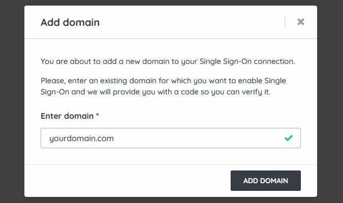

  2. Select Add Domain and submit your domain name with the format yourdomain.com.

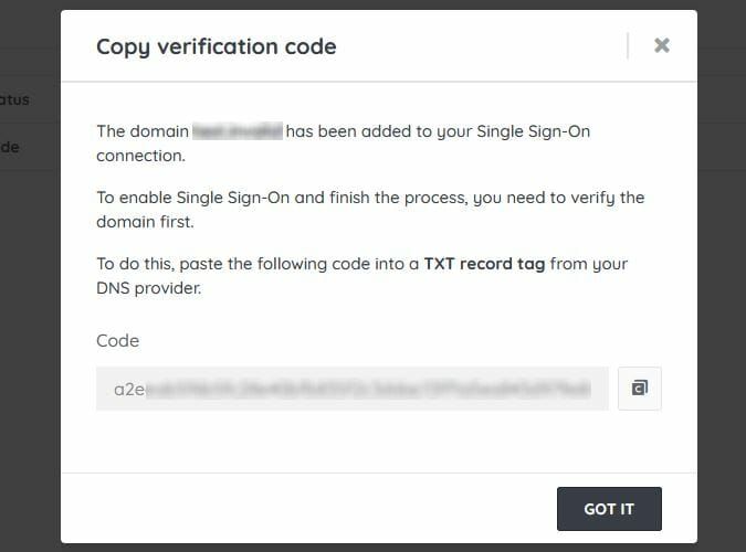

  3. Copy the code presented in the pop-up.
    You will need to add this code as a TXT record to your domain's DNS provider to verify the domain. If necessary, consult the website and documentation of your specific DNS provider for up-to-date instructions on how to set up the TXT record.
    Adding the TXT record in DNS is an added security measure to verify that you own the domain. Once the domain has been verified, you can remove the TXT record from your DNS configuration.
  4. Select Got it and wait a few minutes for the DNS verification to automatically happen. Alternatively, select Verify Domain.
  5. Select Enable domain once your domain is verified.

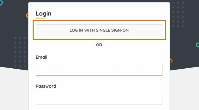

Once you've set up your SSO connection new and existing Lansweeper Site users in your domain should be able to log in by selecting Log in with Single Sign-On. They will be asked for their email address prior to starting the SSO login process.
