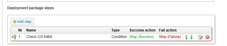

  The last version Lansweeper  check 64bit OS Architecture failed when deployment package.
Lansweeper Server V12.4.0.2

Joney
 I try to deplopy the 7-Zip, but it failed, so I remove all others steps, just left the check OS. I find that it successful when the client OS is 32bit(change the condition to 'is 32 bit' ), but failed  when the OS is 64 bit. I think it works before version 12.4.0.2.
