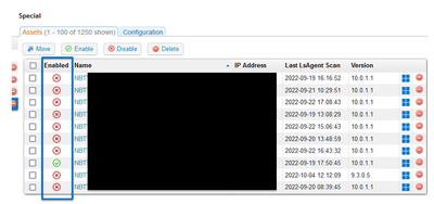

I'm getting closed to the answer I need. I noticed some of the PCs in Scanning\LsAgent Scanning has been disabled for LsAgent scanning. May I know what action/config could have set it to "Disabled"?
Obi_1_Cinobi
Hello there!
This quick tech solution will shed some more light on this: https://community.lansweeper.com/t5/quick-tech-solutions/how-to-re-enable-disabled-lsagent-clients-i...
