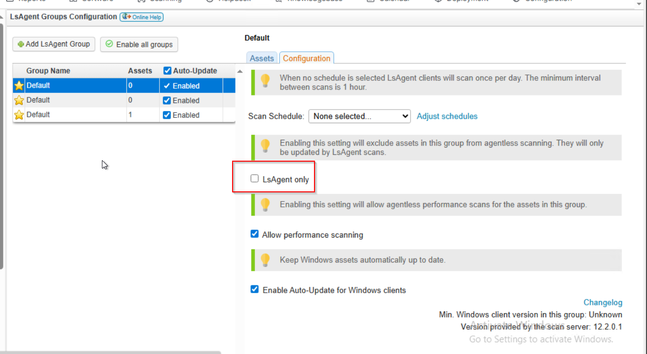

If you want to bypass the agentless scan because you have LsAgent already on the asset. Lansweeper has a feature under Scanning\LsAgent Scanning\Configuration. Enable LsAgent only. This will skip any agentless scans for the asset with LsAgent installed on them.
