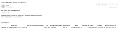

Then in my E-mail/Export reports section I added this highlighted section to get the reports straight in my inbox.
Result looks like this:
Hope this helps.
