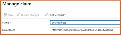

 I uploaded an example of the claim in Azure to help anyone else who may be struggling.

We experience the exact same error, which was resolved with the information below. There were two changes required for our organization [Disclaimer: Our config does not use IdP initiated SSO];
1. Add the sign on URL (optional) as https://app.lansweeper.com and...
2. Update the Attribute claim with a namespace.
For us, while the attribute claim use is emailaddress (default) the namespace field was empty causing SSO to fail. After Lansweeper SSO migration it appears that the Email Claim schema (found in Lansweeper SSO config) is required in the namespace field (Your Enterprise App > SAML > Attributes and claims).
