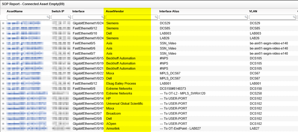

hendrikve
Hi Thierry,
We ‘translate’ the discovered MAC addresses of unknown devices (without known IP or asset data) using an OUI table that we’ve manually imported in the Lansweeper DB.
We created a custom report that ‘automagically’ shows us newly discovered (rogue) devices connected to our managed switches, together with the manufacturer information and ao. the configured VLAN.
See an example below:
