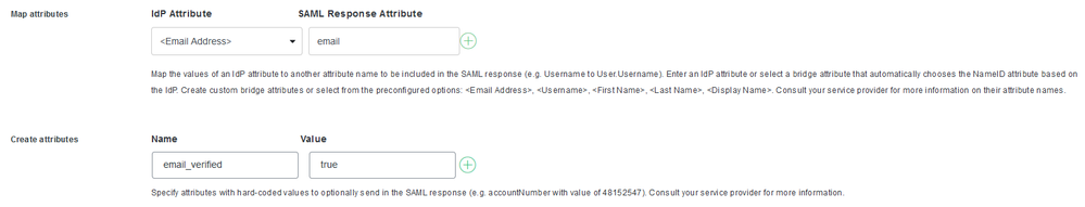

For anyone setting up DUO with LANSweeper Cloud SSO, this is how I finally configured the app on the DUO side; and it always turns out to be the simple solution that works 🙂
Just map the default idP attrb to "email" and then of course manually create the "email_verified" attrb as well:
