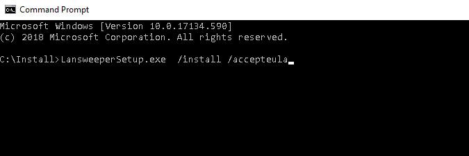

You can perform a silent install, uninstall or update of Lansweeper via Windows Command Prompt (CMD). This can be done attended or unattended and can be very useful when setting up large environments with multiple scanning servers in an automated way.
To use the silent install feature, open a Windows Command Prompt with elevated permissions. You can find an example CMD below:
As of version 10.5 the parameter /classic is no longer required to install the classic version of Lansweeper. However, you will still need to select your management type in the first run wizard. You can still use /classic to skip the selection screen and go straight to on-premise management
