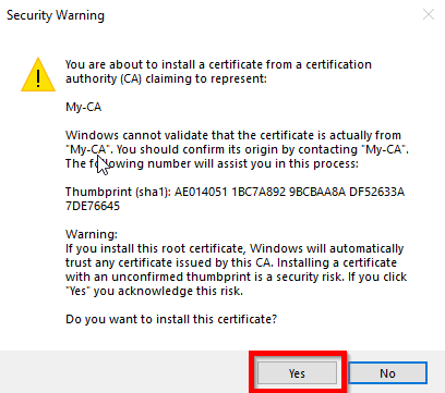

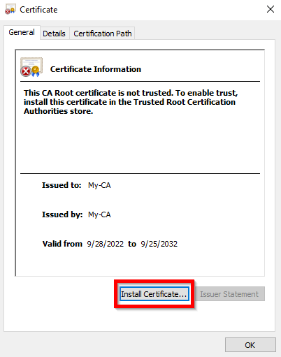

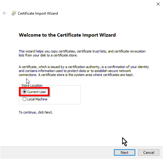

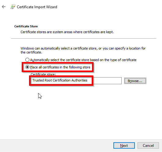

Install the root CA on the user's Windows machine
Double click on the ca.crt file

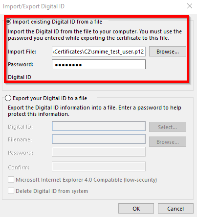

Install the smime_test_user.p12 certificate&key in Outlook

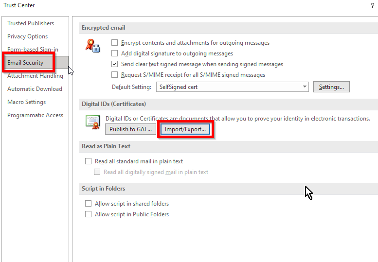

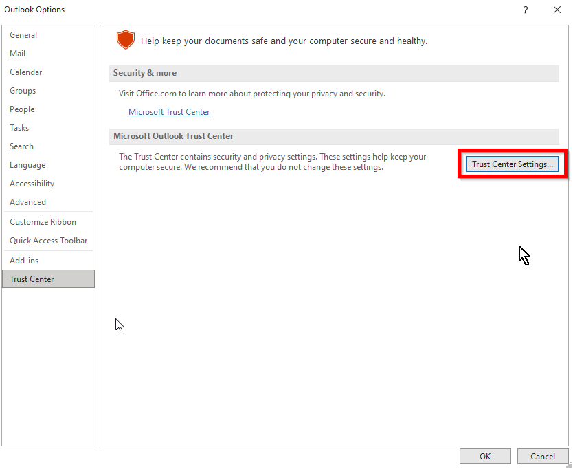

Go to Outlook options, then Trust Center Settings.

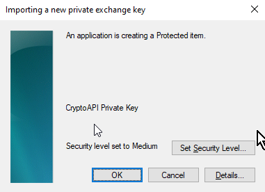

Import the smime_test_user.p12 file here. You need to supply the password you used when creating the p12 file.

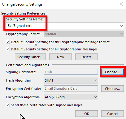

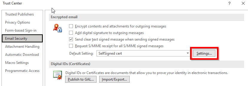

 Go to Encrypted email Settings…
And Choose… your certificate. You need to give a Security Settings Name too (any name):

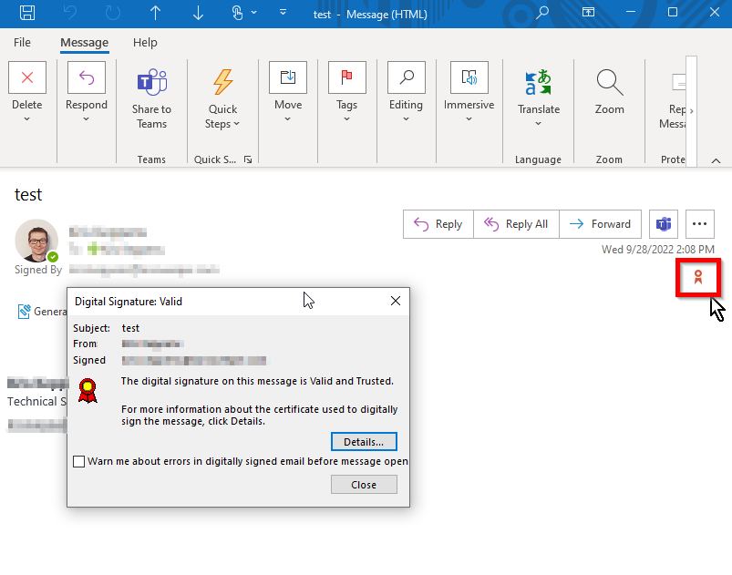

Phase 3: Now you can send a signed email!

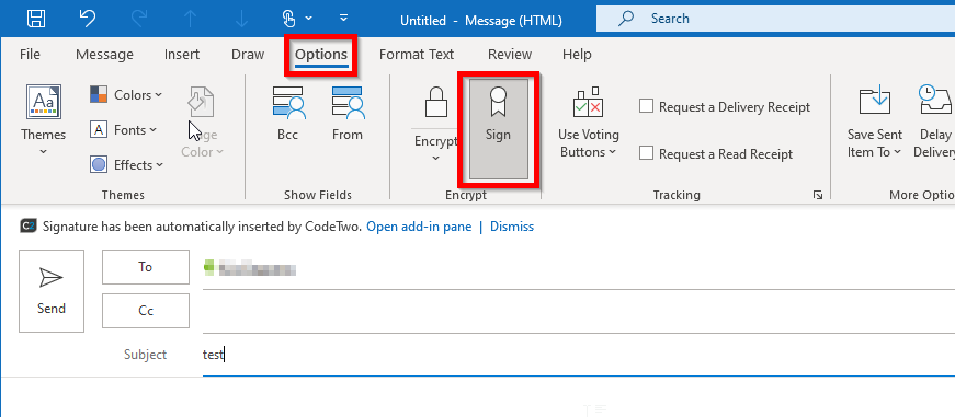

Create a new, email, then go to Options and enable “Sign
On the receiving end, you will notice the certificate icon on the email.
Note:
Since it is a self-signed certificate, the receiver will have to explicitly “Trust” the certificate or install the ca.crt too.
