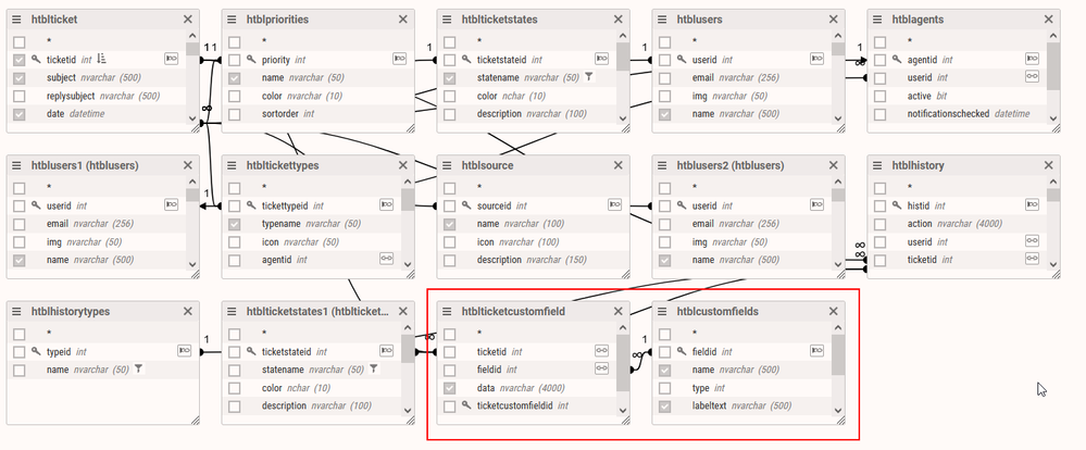

Taking an all tickets view I''ve modified a starting report point to drill down into what I think is the correct table data, since there doesn't seem to be any "Last Editor" type fields anywhere as you've undoubtedly noticed. I'm posting the code and a picture of my understanding of the layout.
From the htblticket table, link to the htblhistory, then thru the agentid to the htblagents table, then using the userid of the agentid, pull the name from the htblusers1 table. Make sure the htblusers1 table doesn't link back to any other tables or it seems to pull the creator of the ticket.

Not sure if this is what you're looking for, but here's an attempt with the limited scope you've given above.
Assuming your adding a custom ticket field to the Ticket Content section, called Last Editor, and using a combobox for the editor names (or regular text if you wish to add the names manually), that data is kept in two tables, htblticketcustomfield and htblcustomfields.
Here's the test I built to research this question.

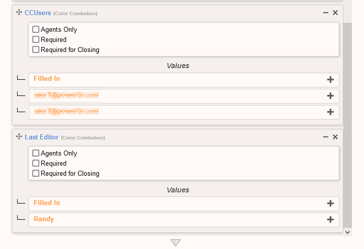

1. Added a custom ticket content called Last Editor, Color Combobox (because why not), added my name (Randy).
Custom Ticket FieldCustom Ticket Field

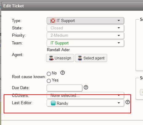

2. Added this custom field to my standard helpdesk ticket.
Custom Field added to TicketCustom Field added to Ticket

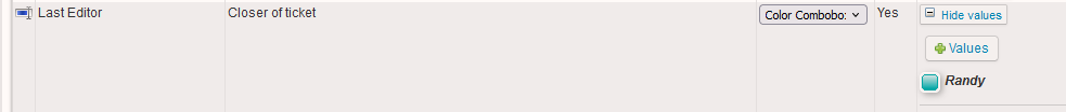

3. Created a test ticket and selected the Last Editor, closed the ticket.
Custom Field in Ticket.Custom Field in Ticket.
4. Ran the below attached report to find the links. This report is modified from the stock Helpdesk: Tickets closed in the last 7 days. The only added part relates to the two tables. With this information you should be able to use the htblcustomfields name to filter out the Last Editor link with the htblticketcustomfield Data information.
Tables where custom fields are.Tables where custom fields are.Report output.Report output.
