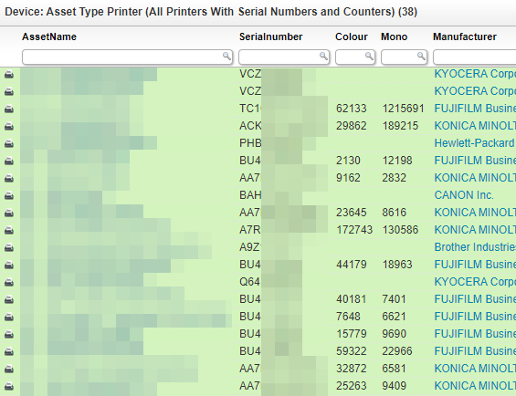

First off big shoutout to @Esben_D for his assistance in getting this working.Short Story: We are a construction company that has a bunch of printers through a printer vendor. These printers tend to move around a bit when projects finish up and start-up. The vendor is notified and moves the printers for us etc, but they seem very slow to process the updated details for site locations.
Our poor receptionist gets calls & emails from them month chasing usage counters for the printers and the locations eg if we still have them.
Thanks to Esben and Lansweeper we have this custom report that gets emailed to her monthly with the printer location/serial number and print/page counters for the reporting. Previously she was having to call around to all the sites and have a staff member on-site read out the details etc.
Why spend 10 minutes calling sites when you can spend 3x days automating it 😛 It will save time in the long term. And the 3x days was an exaggeration but a bit of IT Humor.
Note you will need to set up custom OID scanning if you want to pull this data.
The biggest issue was finding the necessary OID's for each printer. Thankfully we only use Fuji and Konica so didn't need to find too many.
Code in question

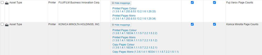

Scanning > Custom OID Scanning > OID Scanning Targets

To learn more about custom OID scanning, you can refer to the below Knowledge Base articles:
CyberCitizen
Honored Sweeper
OID's that we use. Also note in the report you need to reference the Mapped SNMP Data name you give it, eg Printer Pages Colour.
FUJIFILM Business Innovation Corp.
Printed Pages Colour(1.3.6.1.4.1.253.8.53.13.2.1.6.1.20.33)
Printed Pages Mono(1.3.6.1.4.1.253.8.53.13.2.1.6.1.20.34)
KONICA MINOLTA HOLDINGS, INC
Printed Pages Colour(1.3.6.1.4.1.18334.1.1.1.5.7.2.2.1.5.2.2)
Printed Pages Mono(1.3.6.1.4.1.18334.1.1.1.5.7.2.2.1.5.1.2)
Copy Pages Colour(1.3.6.1.4.1.18334.1.1.1.5.7.2.2.1.5.2.1)
Copy Pages Mono(1.3.6.1.4.1.18334.1.1.1.5.7.2.2.1.5.1.1)

Note there are some machines that are blank, that is because we have not setup custom OID's for those printers as they are label printers or small office printers that we do not need to report on.
