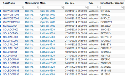

1. You can add
tblADusers.Firstname,
tblADusers.Lastname,
tblADusers.Name,
tblADusers.Displayname,
2. There are no duplicates on the your screenshot - every asset has 2 sequental warranties.

‎07-18-2023 12:51 AM
FYI i talked to a SQL program about the duplicates entrees had me and Min to 2 lines
Select Distinct Top 1000000 tsysAssetTypes.AssetTypeIcon10 As icon,
tblAssets.AssetID,
tblAssets.AssetName,
tblAssetCustom.Manufacturer,
tblAssetCustom.Model,
Min(tblWarrantyDetails.WarrantyEndDate) As Min_Date,
tsysAssetTypes.AssetTypename As Type,
tblAssetCustom.SerialNumberScanned,
From tblWarranty
Inner Join tblWarrantyDetails On tblWarranty.WarrantyId =
tblWarrantyDetails.WarrantyId
Inner Join tblAssets On tblWarranty.AssetId = tblAssets.AssetID
Inner Join tsysAssetTypes On tblAssets.Assettype = tsysAssetTypes.AssetType
Inner Join tblADusers On tblADusers.username = tblAssets.username And
tblADusers.userdomain = tblAssets.userdomain
Group By tsysAssetTypes.AssetTypeIcon10,
tblAssets.AssetID,
tsysAssetTypes.AssetTypename,
Order By tblAssets.AssetName,
Min_Date Desc
