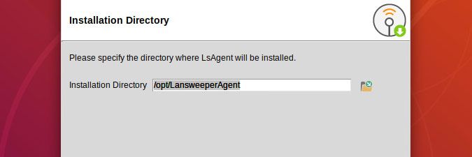

  8. Choose an installation directory and click Next.

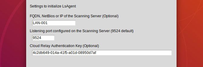

  9. Submit one or both of the following:
    • Your scanning server name or IP and its listen port.
      You can see your listen port (9524 by default) listed in the Configuration > Server Options section of the web console. If you fill in these fields, LsAgent will first try to send scanned data directly to the listen port of your scanning server.
    • The Cloud Relay Authentication Key you copied.
      If you fill in this field, LsAgent will send scanned data to the Lansweeper relay server, where your scanning server can collect it. If you submit both your scanning server and relay authentication key, LsAgent will first try to send data directly to the scanning server and, if that fails, to the relay server. Data is securely sent to the relay server over HTTPS, stored in an encrypted format and deleted once a scanning server has retrieved it.

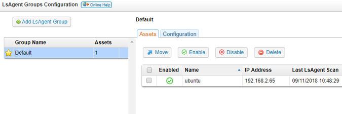

Scan Linux using LsAgent

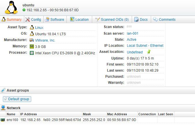

The client machine will automatically be scanned by LsAgent, by default once per day. Data will be sent to the scanning server and, if that fails, to the relay server, where the scanning server can retrieve it. You can find the client machine in the Lansweeper web console like any other Linux client machine by performing a search for the computer's name in the search bar.
Scan schedule
You can choose to change the machine's scanning schedule in the Scanning > LsAgent Scanning section of the Lansweeper web console.
Here you can divide machines scanned with LsAgent into groups, configure a scanning schedule for each group and enable/disable/delete LsAgent installations. Keep in mind that the minimum scan interval for LsAgent is 1 hour. If you choose a more frequent schedule, your LsAgent installations will silently default to an interval of 1 hour. LsAgent uses the same schedules as deployment packages, so the link for creating a new schedule takes you to a deployment configuration page.
