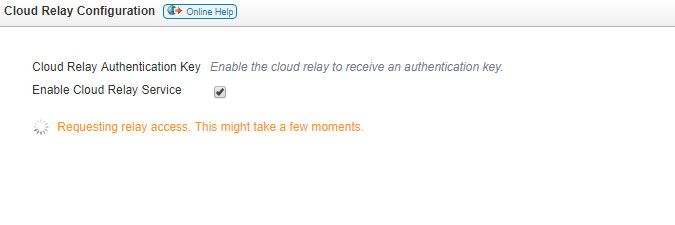

  3. If you will be scanning the Mac computer over the internet, enable access to the Lansweeper relay server under Scanning > Relay Configuration in the Lansweeper web console. The relay access check may take a minute to complete. If you have multiple scanning servers, you can configure which one collects relay data.
    The LsAgent relay configuration can only be switched on from the Lansweeper Classic web console. If you don't have access to the web console yet, see enabling the Lansweeper Classic web console.

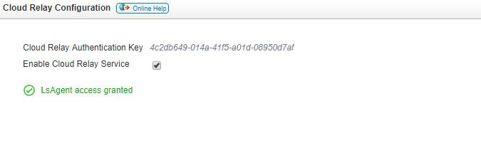

  4. Copy the Cloud Relay Authentication Key seen on the page, as you will need to submit this in the LsAgent installer later.

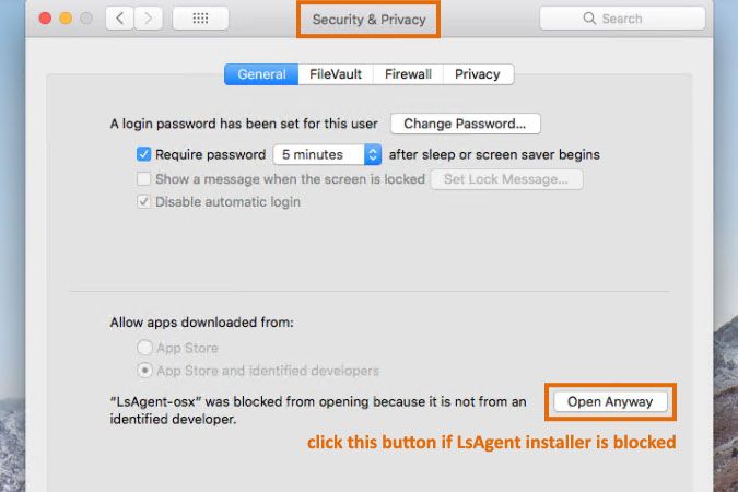

  6. Run the LsAgent installer on your Mac client machine, double-click LsAgent-osx in the resulting pop-up and choose Next. Should the software be blocked, click the Apple icon in the upper left corner of your screen, choose System Preferences followed by Security & Privacy. There should be an option to unblock the software in this menu.

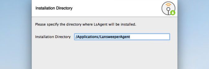

  8. Choose an installation directory and click Next.

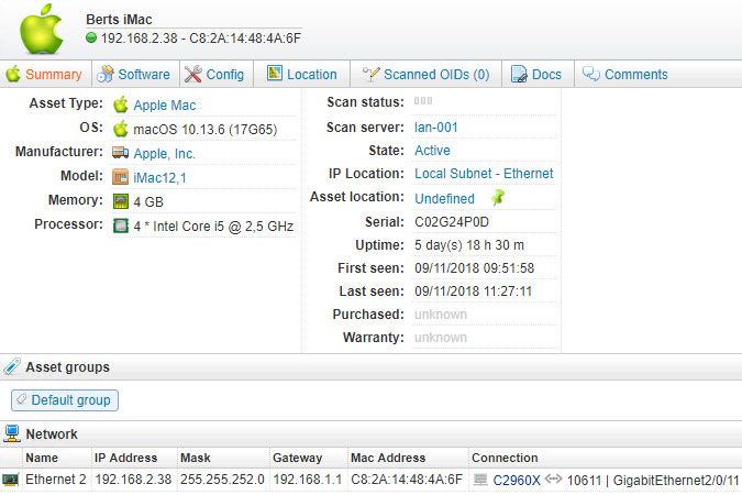

The client machine will automatically be scanned by LsAgent, by default, once per day. Data will be sent to the scanning server and, if that fails, to the relay server, where the scanning server can retrieve it. You can find the client machine in the Lansweeper web console like any other Mac client machine by performing a search for the computer's name in the search bar.
